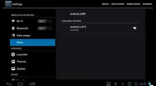

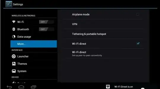

Here are 2 screenshots from my viewsonic g-tablet that is running ICS (this is not a CM9 Kang, it is vanilla AOSP android). The first shows the setting, the second shows that i turned it on. enter image description here enter image description here
