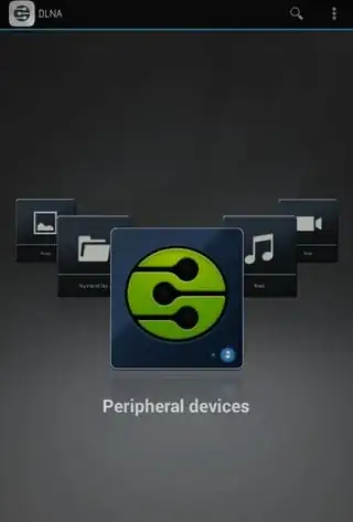

Option 4 -DLNA (with wired or wireless LAN)
Uses a similar method to miracast, but has slightly different requirements;
  • Android DLNA app ( choose one from playstore)
  • The TV is already DLNA enabled.
Steps
  1. Connect your TV(and/or) Android device to a same WLAN network. Under Network settings on TV choose automatic setup, however if it can't detect other devices then use static IP address.
  2. Configure your DLNA server ( Android) and select the files/movies and enable sharing.
  3. For example my setup looks like this:
DLNA android device
DLNA android (click image for larger variant)
Android DLNA media server
  1. After sharing, just go to your TV and select DLNA and you should see your shared movies (Ethernet connection is faster than WLAN connection)
