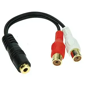

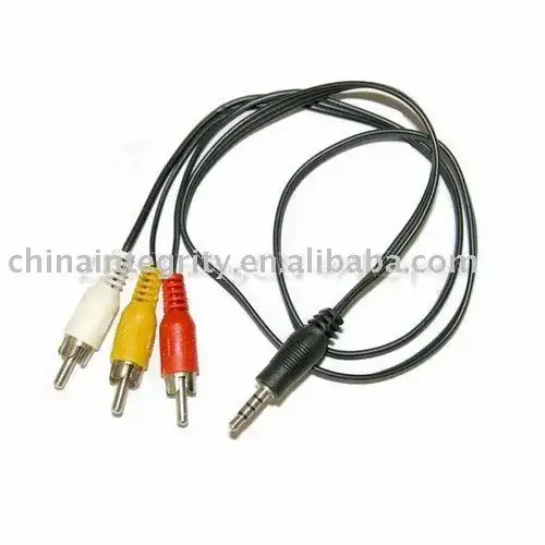

Today i have made some progress in this question. On iPhone you can buy a iRig Mic which can do the job (and it should work on android too). But since i want to use another external microphone i have decided to make the adapter myself from some different adapters (which does the same thing as iRig Mic, but with a female 3.5 mm jack output, so i can use my wireless microphone with it)
I have ordered the parts from an online store in denmark, but you can get it all over the internet, you just need to know what you need :)
The first thing you need is a 3.5 mm male 4 pole conductor jack (TRRS) to RCA adapter. Like this one jack to RCA Then you need a RCA to either female jack or XLR adapter (either if your mic has a jack or XLR output) Like this one Female jack to female RCA And thats all.
Then you can plug everything together and use the mic of your choice on your Android phone.

  • Hi Matthew.. Maybe i was not precise enough. It is a microphone like this one: http://www.podconsult.dk/wp-content/uploads/audio_technica-2-1024x1024.jpg I like use, and then i need a connector from it (3.5 mm jack 2 pole) to the Galaxy Nexus 4 pole jack connection. I have found one for the iPhone 4 http://www.podconsult.dk/wp-content/uploads/KM-IPHONE-MIC-2.jpg but im not sure the iPhone 4 is build in the same way as the Galaxy Nexus (they both have 4 connection areas on the 3.5 mm jack but i'm not sure they are made so the mic is at the buttom on both of them)... – dev0 Feb 14 '12 at 09:23

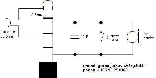

I am unable to answer your question fully, but the part "and I don't know if the lower or middle or upper part is for the microphone", you can verify it quite easily.
What you need to have is a head phone that came with your device or the one that works (both mic and headphone speaker should work), a 1.5V battery cell and a pair of small wire.
Just wear the headphone and hold the battery in your hand with one wire connecting the battery's negative terminal to your head phone's lowest terminal (ground). Connect another wire to the positive terminal of the battery and touch the other end of the wire on any other terminal of the headphone connector. You can hear a pop or hiss on one of your ear. If you do not hear anything, then it could be the mic or you haven't completed the circuit. By this way you can identify the parts of the head phone connector (Right, Mic, Left, Ground, generally in this order, but varies from device to device). If you are ready with believing what you is see, then the following image will explain.
Narayanan
