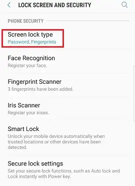

Following @beeshyams's answer, here are my current settings.
settings screenshot 1 settings screenshot 2 settings screenshot 3 settings screenshot 4

Samsung has its own ways of implementation so this may differ but stock implementation :
Fingerprint can unlock the phone after it goes to sleep ( Settings &radar; Display → after xx minutes of inactivity) only if Power button is not used to lock and default lock screen is used
If you enable power button locking or any third party screen lock / launcher that can lock screen, you can't unlock with fingerprint. You require to enter PIN
That is a far more easier way of achieving what you want (though you can't configure the delay) going by the need in your example
If you really need a configurable interval, that may be possible but would surely need root

  • This doesn't seem to work. There's no difference if I lock the phone with the power key or just let it turn off after a minute. In both cases I can unlock with my finger. Even if it did work, I would'n just leave my screen on for a minute (or many minutes) because that would drain the battery and the phone might do stuff while unlocked in my pocket. I've added screenshots of my current settings. – Alex Jan 29 '18 at 13:57
  • As I said in the beginning, Samsung often does things differently. So the power - lock option is ruled out. Next you can try with a screen lock app of your choice or any other app, for instance I use Quick App lock which overrides default screen lock – beeshyams Jan 29 '18 at 14:03
  • How would you set this up with Quick App Lock? Suppose I want to be able to use my fingerprint to unlock the device as many times as I want, but have it require a password unlock after 30 minutes. Once I unlock with a password I can use fingerprint unlocks again for another 30 minutes. – Alex Jan 29 '18 at 21:51
  • That's not possible. The app I mentioned was an example of default screen lock being changed.. you may use any other app -just search for lock screen on Play store – beeshyams Jan 30 '18 at 01:19
  • Using such an app is to only ensure that you can only open with PIN always. Not use fingerprint + Configurable time lapse PIN – beeshyams Jan 30 '18 at 01:25
