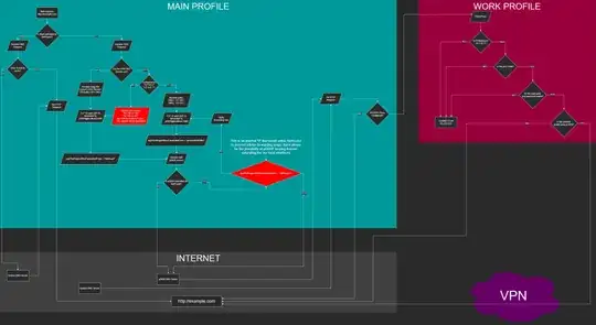

There's many ways to go about this (sorted from easiest to most complicated):
  • Use Adhell 3, the Samsung KNOX based content-blocker that doesn't require root and also allows you to use a VPN app at the same time.
  • Use AFWall+ (root required) instead of NetGuard. That way you can use a VPN app "normally".
  • Install a VPN app and a SOCKS5 proxy server in the Android work profile, and then connect to this SOCKS5 proxy from the main profile using NetGuard.
  • Use a VPN provider that already offers a SOCKS5 proxy (like Mullvad), and then connect to this SOCKS5 proxy from NetGuard (Not recommended due to Netguard leaking UDP by not routing it through the SOCKS5 proxy. Also SOCKS5 is not encrypted)
  • Self-host a VPN-to-SOCKS5 server (Not recommended due to Netguard leaking UDP by not routing it through the SOCKS5 proxy. Also SOCKS5 is not encrypted)
I've only ever used the highlighted option, so that's what I'll describe here.

Here's a flow chart of how/why this works: enter image description here
I made a much more detailed guide on my blog. It's linked below:
How to use NetGuard + personalDNSFilter+ Any VPN, without root, without external self-hosted servers.
https://itsignacioportal.github.io/netguard-pdnsf-any-vpn-combo/
