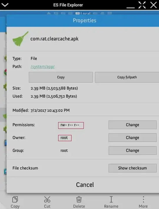

As suggested by @Firelord, you can eliminate the hussle of entering commands (and possibly reduce the likelihood of errors) using a file explorer such as the one mentioned already.
For instance with ES explorer, simply long press the target .apk file and choose properties then edit:
Afterwards you get proper permissions i.e -rw- r-- r-- and owner i.e root:
Disclaimer: the app used above in example is my own-made app, so you won't find it in playstore
