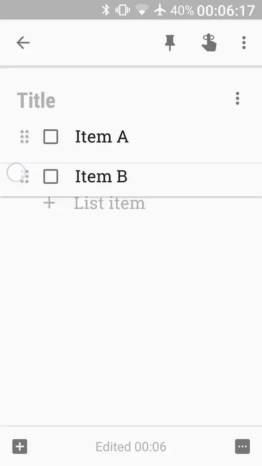

There is a small ribbon next to the check box. You can drag and move list entries with that.

    It makes sense, but the ribbon never worked for me. I tried click-n-drag, press-n-drag, double (click then press and drag), but I can never move the items. I seem able to mark the items as done, I can edit items, etc. but not move them. Is there maybe some lock I have to release or something along these lines? Thanks in advance! – Kurt Schmidt Apr 15 '18 at 05:40

In order to get the drag to work, I had to first click "+ List Item". This made the ribbons "dragable"for me.

When using my phone, I finally figured it out after trying just about everything. Make a very slight sweeping/swiping motion over the dots to the left of the item will stick it to your thumb right away so you can drop it elsewhere. Note, your thumb needs to be in the swiping motion before touching the icon... touching the icon and then sweeping will not work. Just touch the icon midway during the swiping. Just do the slightest little sweep or swipe, no clicking or pressing and holding worked for me. Works easily now 100% of the time with this itty bitty sweep on the icon, at least for me. Good luck, hopefully they will improve this.
