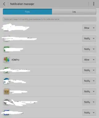

  • Enabling a persistent notification to keep the program's services running in the background. (Settings >> Notification Manager >> Always allow) See screenshot:
ADM persistent notification
Screenshot (click image for larger variant)
Also keep it running in background through phone manager:
b
(I apologise to hide some apps names due to other reasons but I trust it wont affect the quality of the answer)
