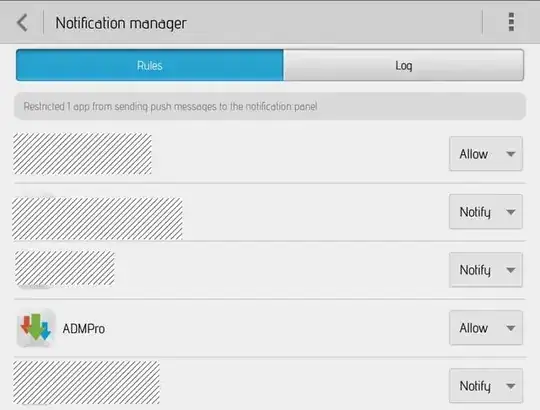

For you to download on schedule, ADM requires a running service program. Make sure you do not close the service after you have enabled your scheduler.
You can do this by:
  • Giving ADM a higher memory priority (so that it will not be killed when system memory is low)
  • Whitelisting ADM in phone's power saving features, task killers or hibernation programs
  • Enabling a persistent notification to keep the program's services running in the background. (Settings >> Notification Manager >> Always allow) See screenshot:
ADM persistent notification
See: How to schedule downloads in Advance Download manager, and check if it works
