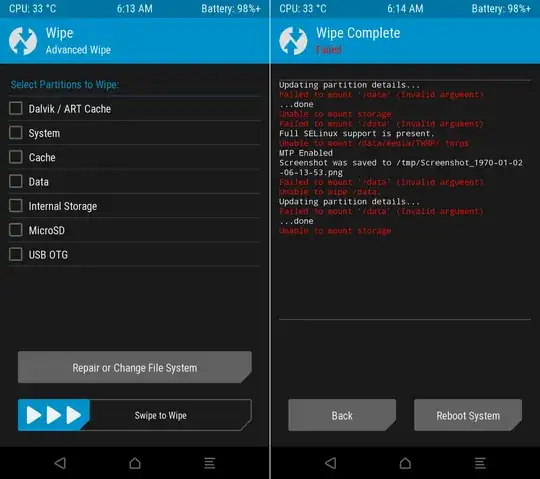

I have a smartphone that is running Android 6.0 Marshmallow. I encrypted the device using the builtin mechanism. Unfortunately I forgot the password (intentionally). The only option to recover the phone is to Factory Reset the device, either from its recovery mode or using fastboot.
My smartphone has the TWRP recovery. When I wanted to Factory Reset the device using this mode, I simply couldn't do that because TWRP wasn't able to mount the /data/ partition:
So the question is simple: How to Factory Reset an encrypted device using the TWRP recovery? Is that even possible? Does TWRP recovery support this action?

  • Is your recovery ported or buold from source, maybe developer screwed recovery.fstab file. In theory twrp shouldn't have problems with /data encrypted. However if you can't wipe from twrp. Flash stock firmware it should handle things. – Једноруки Крстивоје Feb 11 '17 at 19:14
    The TWRP recovery was ported from another device. I wrote the fstab file and wiping unencrypted /data/ partition works well. I added length=-16384 and encryptable=footer to the /data/ entry, but this did nothing (I know the key is at the end of this partition and not on a separate one). I also know that the stock recovery can fix this, but I just want to do it via TWRP. – Mikhail Morfikov Feb 12 '17 at 10:53
  • You are probably doing some wrong with .fstab. Ask question on stack owerflow or xda, developing and programming questions are offtopic here – Једноруки Крстивоје Feb 12 '17 at 11:43
  • TWRP > “Wipe” > “Format data” to re-format and mount “/data”, which deletes all data. – caw Oct 07 '20 at 19:24
I've managed to solve this issue. Apparently the ported TWRP image didn't have support for encryption. That's why it tried to mount the encrypted /data/ partition. I've build the image from source, and I've set the following flag:
TW_INCLUDE_CRYPTO := true
Now it can detect the encrypted partition:
The only problem is that it can't decrypt the data with the right password. Maybe something else is missing.
