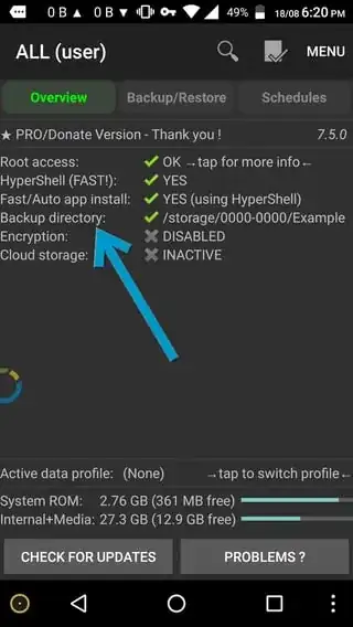

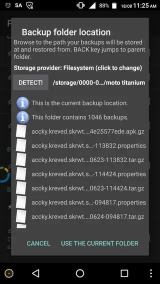

  1. Menu → Preferences → Backup Settings → Backup folder location to display the current backup location (in pic below /storage/0000-0000/moto titanium is my current back up location, where 0000-0000 is my external SD)
  2. Press Back key (to jump to parent folder of device) →Create a new folder → by name Example

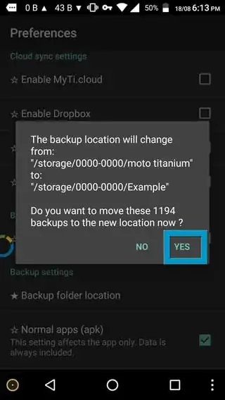

  3. Select Use the Current folder and on the nest screen accept the prompt to move all earlier backups to new folder. (takes some time depending on the number of backups and it may look like app is doing nothing, be patient, it is working)
  4. You are done ! To confirm that the location has changed refresh the application by hitting Back or reload to go to the home screen and see the changed location
