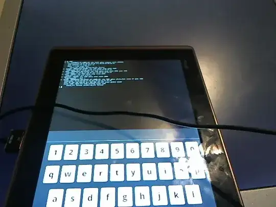

I am trying to login to Android Eee pad transformer from my other linux box using SSH. This are the step i followed and failed. So asking here for the correct answer.
1) Go to Android market and download install Connectbot
  • Launching ConnectBot
  • Asks ssh or telnet or local
  • Press local
  • Asks username
  • Username applied dummy
  • Connected to local Android
  • type ip addr; in the terminal shows ip address and i can ping 8.8.8.8
2) Now i want to access to this box from outside box
  • Go to Android market and install SSDroid and SuperUser
  • Launch SSDroid
  • SSDroid says root:off, sftp://root@ipOfthisAndroidBox:2222 ready
  • From another box i try to login using ssh root@ipOfthisAndroidBox:2222 fails
3) Launch SuperUser it tries to install something but fails
All i get to verify am i rooted, always it shows:
$ su
su: permission denied
Follow up: How do i login after installing SSHDroid?
