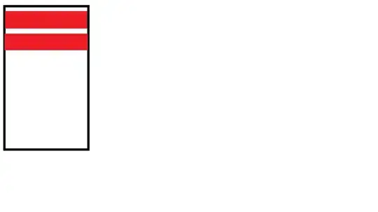

This is a weird touch screen issue as only part (2 blocks) of the screen is not working. I tested the touch functionality via "Touch Test" and observed that 2 red zones are not responding to finger tap (see screenshot). Where there are 2 thin gaps (actually 2 lines) are responsive. This happened after an app update (15 apps). I didn't drop the phone during this period. So I am suspecting this might due to a software issue. What could cause this issue?
Stan
  • 265
  • Try rebooting. I used to have this problem in my old phone...part of the touch screen wouldn't work. Those times i would pull down the notification bar and close it. After that the whole screen would become responsive again. – Karthik Nov 02 '11 at 09:48
  • No luck after rebooting. I am going to reset the phone to factory setting (or upgrade the firmware and wipe the phone) to see if it's a hardware issue. This is the last thing I want to do before any possible way to identify the issue. – Stan Nov 02 '11 at 17:34
  • Was there any water exposure? Was it dropped at any stage, before or after installing apps, despite I didn't drop the phone during this period? 15 apps would not do that... just saying :) – t0mm13b Jan 21 '13 at 17:27
    There is an option in Settings->Developer options->Show touches which when enabled will show a blip on the places where you touch. Try enabling to see whether you could see the blips in the area that you reported not working. – Narayanan Dec 23 '13 at 07:46
