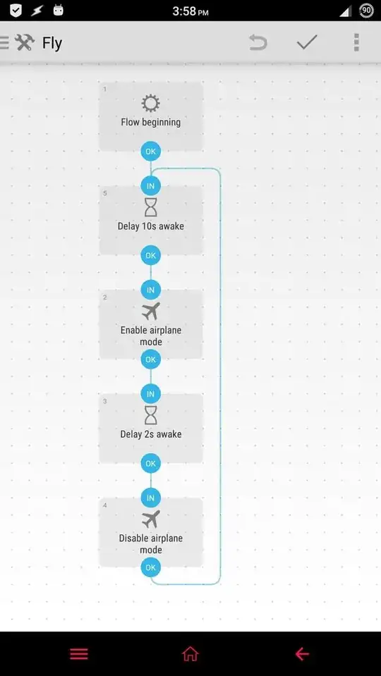

I suggest you try an app in this case. For example:
You can use Automate app here.
(Click image to enlarge)
IMG:
  • The block for Airplane mode is available under Connectivity category. (Requires root access.)
  • The Delay block can be traced back to Date & Time.
Configure them as you wish. Make sure to have the flow run in a recurring manner, such as shown in above screenshot. You can also setup a trigger for full automation or manually start the flow.
