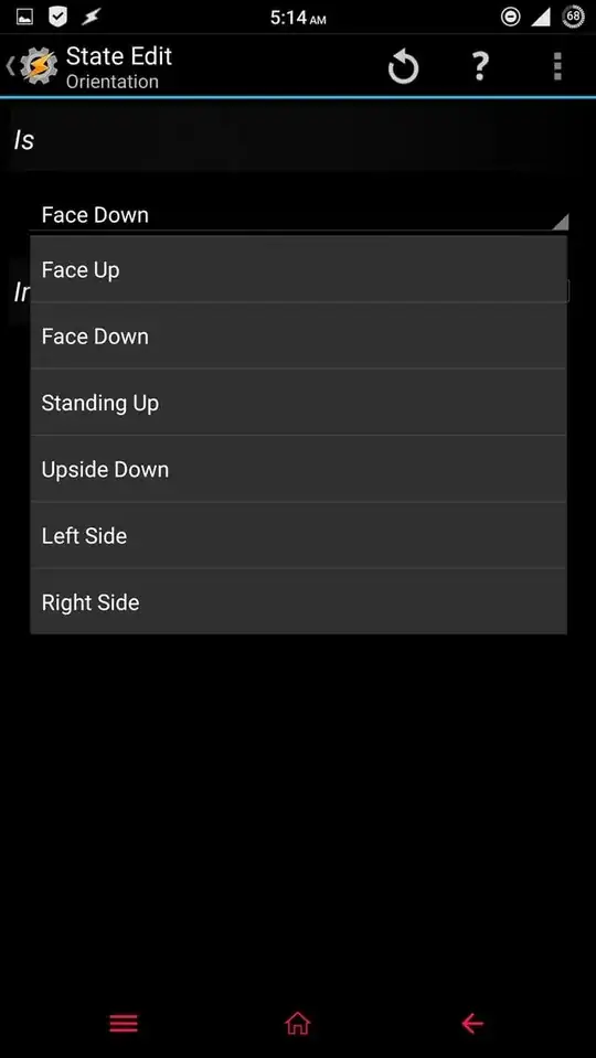

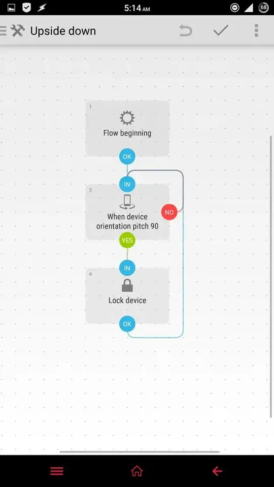

I suggest you try Automate (user guide) as well as Tasker (free trial; user guide). Both of them offer the features you're seeking. A peek:
(Click an image to enlarge it)
IMG: IMG: IMG:
Before I leave you here to tinker with those options, here is some information to ease the tinkering:
In Automate app:
  • Device Orientation block can be found under Sensors.
  • Device lock can be found under Interface. Practical usage requires setting Automate as device administrator.
Tip: It is easy in Automate to trigger an action on a prerecorded motion gesture
In Tasker app:
  • Orientation trigger can be found under State → Sensor.
  • Display Orientation trigger can be found under State → Display.
  • System Lock action can be found under Display.
Tip: In Tasker you can setup multiple contexts.
