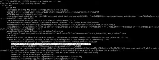

The system service activity logs many important details. Among other things it shows the called package which in this case is Package Installer app with package name com.google.android.packageinstaller or com.android.packageinstaller. It also shows the calling package or the package which launched an another package.
Find the package name
Now, using in PC execute the command:
adb shell dumpsys activity activities      # this command should be executed only when that dialog is in foreground
Demo output: notice the highlighted line:
In the highlighted line, the string after launchedFromPackage= and before userId is the package responsible for launching Package Installer app. In your case it would be a different package name. Note down that package name (henceforth denoted as <pkg>).
