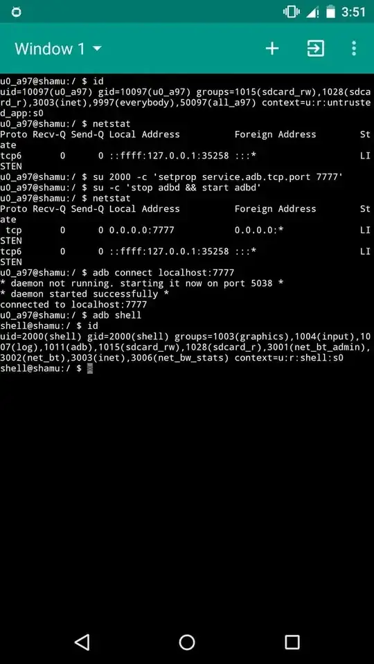

I should stress that it is futile to even think about running adb client related command on a device without access to PC for once or without root access. I have already noted the procedure in regard to PC in revision 1. If you do have root access and still need to use adb on device then do:
su 2000 -c 'setprop service.adb.tcp.port  PORT'   # choose PORT greater than 1024.
su -c 'stop adbd && start adbd'                   # this would stop and start adbd.

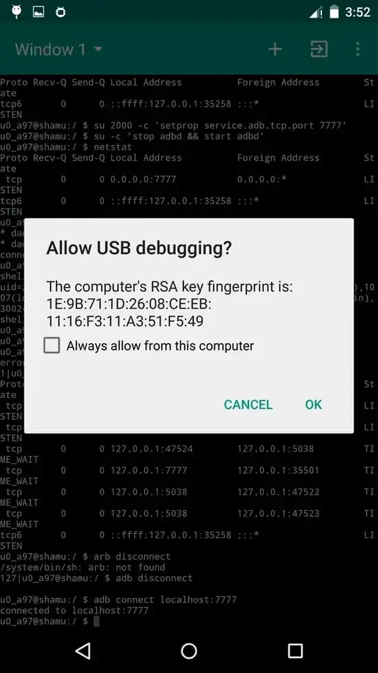

su -c adb connect localhost:PORT                        # you shall now be connected and would be required to accept fingerprint to authorize USB debugging.
(Click an image to enlarge it)
IMG: IMG:
