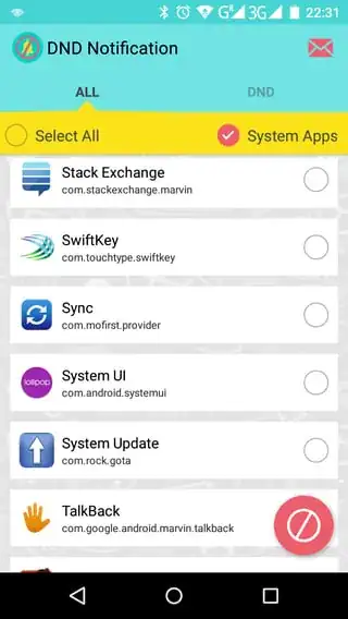

To find out what's going on, I followed Izzy's suggestion on trying some Filter/block notifications apps. Took a few tries, but one of them (Notification Block(DND Notify)), when showing System Apps, showed me this:
DND output (click for a larger version)
From that, we can see that the App calling itself System Update which is defined as a System App has the package com.rock.gota . A google for that shows many other people complaining about getting adverts on their lock screen from this app which their phone manufacturer had "helpfully" bundled into their base Android Image, just as Micromax have done :(
As I don't have a rooted phone, I couldn't use that tool to disable the notifications. Instead, I headed to Settings then Apps, discovered I could swipe right a few times to find All (wish I'd known that before!), scrolled down to this annoying System Update spammy advert app, and did a Force Stop. The Disable button is grey'd out, see How can I disable a stock app that has its Disable button greyed out? for how to get rid of an app like this now it's identified.
