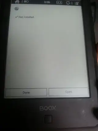

I have a non-rooted Onyx Boox C67ML Carta running stock Android 4.2.2.
I just installed Orientation Locker. I transferred it from my phone using Shareit, but on my phone it had come from the Play Store.
Once installed, when I tried to run it, the whole device totally froze. See below for a picture of what it looks like.
When this device had frozen on me before, I had always been able to force a reboot by holding down the power button. That does not work in the current situation.
I carefully used a knife to take off the back cover to try and find the battery. The battery does not seem to be removable without physically breaking the device.
I suppose I could wait for the battery to run out. It was quite low when the incident occurred. It may actually be out already, and the device off, since e-ink screens may continue to display the last picture they showed when something goes wrong, even without power.
What should I do?

  • Shall we assume that USB debugging is not enabled in your device? For how long did you long-press the power button? – Firelord Feb 06 '16 at 15:25
  • USB debugging was not enabled. The problem is solved too. I'm glad the battery was very low when it happened, otherwise I might have had to wait for quite a long time. – Fiksdal Feb 06 '16 at 15:40
    Oh and I didn't see the second question on your first comment: I pressed the power button for at least 30 seconds, far longer than what is usually required to force a reboot. – Fiksdal Feb 06 '16 at 16:13
The device was not bricked. After a few hours I held down the power button again, and the frozen screen was replaced by the "no battery" screen. After charging, the device is back to normal. I caution users of this particular device not to use apps that try to force the systemwide screen orientation.
It was lucky that the battery was nearly empty when this happened. I suspect that if the battery had been more charged, the wait could have been significantly longer.
