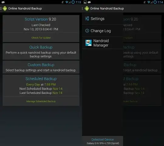

Check the Nandroid Backup application nandroid app img
