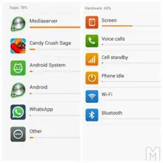

In any case, your device has the facility to identify battery consumption separately for hardware and software (app wise) as shown in screen shot below taken from the same source. Can you study that to identify the culprit, in case of rapid drain? You can quickly weed out the battery hogging apps using this
