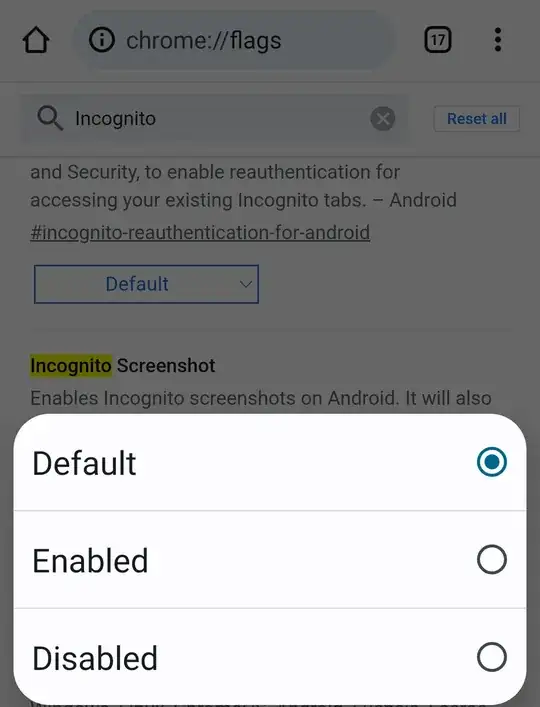

Just for those guys who came here by error in Chrome Incognito mode
Can't take screenshot due to error policy
There is a special flag Incognito screenshots that can be accessed via
chrome://flags
The default value is disabled but if you enable it, you are done. Screenshots are allowed.
