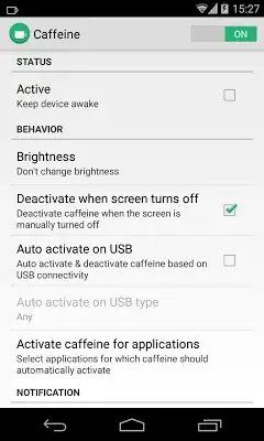

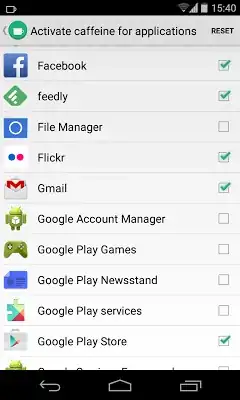

There's a highly-rated Play Store app named Caffeine by Syntaxa which prevents sleep by manual toggle, device plugged in, and per-app.
Compatibility from 2.2 Froyo to 5.1 Lollipop.
It has a 4.5 star rating and 1,355 reviews (as of April 2016)
Screenshot Screenshot
https://play.google.com/store/apps/details?id=nl.syntaxa.caffeine
