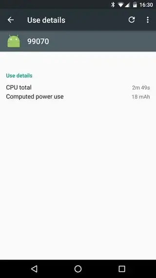

There is a mysterious app, 99070 that is consuming power on my Nexus 5X. Any idea how I determine what it is?
There is no option to stop or uninstall it. My phone is a Nexus 5X running stock Android 6.0.
App 99070 No additional details

    Have you uninstalled any app recently (today preferably)? It looks like an app which was used recently and uninstalled later as it shows a random number instead of app's actual name. – ProPlayerMaxUltra Dec 14 '15 at 17:01
  • I have uninstalled some apps within the last week, but certainly not within the last 2 days. Why would that app still be running? Will a force reboot of the phone work? – CadentOrange Dec 14 '15 at 17:29
  • @Izzy Using app manager I can see such apps as, for example, com.android.wallpapercropper (which is certainly system app), so I'd suppose the "mysterious app" can also be seen there. Or you think it's another, more system-ish sort of apps? – nicael Dec 15 '15 at 19:24
    @nicael I'm not talking about system apps – but about system processes. You usually see them only using ps with a terminal/adb shell. E.g. on one of my devices, this shows "514" for "kswapd0", which definitely is no app (but a daemon ;) – Izzy Dec 15 '15 at 19:28
    Seems to Nexus specific http://forums.androidcentral.com/nexus-6p/607727-unknown-items-battery-usage-screen.html – beeshyams Dec 17 '15 at 08:39
  • Are you rooted? From a root shell try running ps aux | grep 99070 (or whatever the ID is at the time). Could even try find / -name *99070* or grep -r 99070 /. – Matthew Read Mar 11 '16 at 01:24
Possibly right answer:
It's a sandboxed process from a removed app.
For such a number over 99000, it is the Unix UID for an isolated sandbox process (u0_i70).
In Android's UID system, called "AID". Android allocated 1000 special UIDs for isolated sanbox processes, 99000-99999. Some apps use that for security reasons, like Chrome (Incognito mode).

  • This answer may sound weird but that's what an experienced Android developer would give. I'm not a dev, though. – iBug Jul 16 '17 at 17:40
