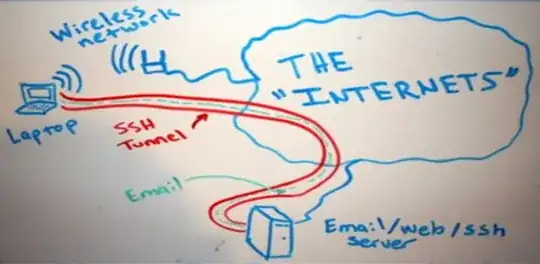

SSHTunnel
SSHTunnel is an ssh tunnel/vpn solution for Android. When I first found SSHTunnel, users were forced to use an application's settings to use SOCK5 proxy, but now sshtunnel can handle per application and global use on its own. Just like rooting is required to get the full functionality of Orbot, you will need a rooted device in order to get what you need from SSHTunnel.
Although this is not a VPN, this is a much simpler setup that will give you an encrypted tunnel to your server. You can interact with your server through this connection directly, or use it to receive or bounce traffic outwards.
  • Note: Unencrypted traffic sent to your server (ie http) will be encrypted through your ssh tunnel, but it will still be clear/unencrypted once it leaves your server.
