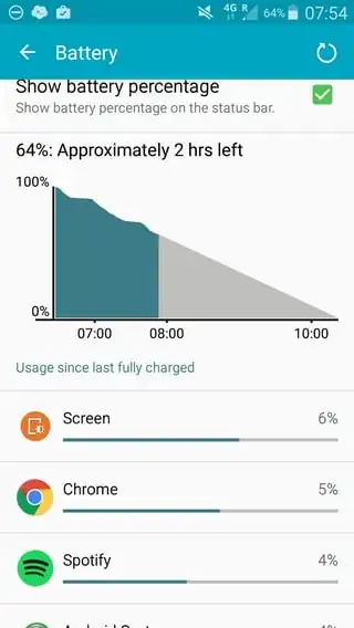

I see this after morning use in Samsung Galaxy 4 and Android 5.0.1:
Screenshot
which is too fast. I am using battery saving mode and disabled step-counter from my phone.
How can you use better battery in Android?
