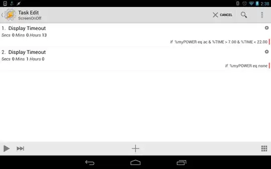

You can do it easily enough with Tasker. You can create a task that:
  • checks if the device is on charge (to do it you can either use the extended variable %myPOWER provided here or create your own global variable)
  • checks for the time of the day
  • sets the screen timeout to 'never'
Create a task with two actions. The first one:
  1. Choose Display -> Display timeout
  2. Set all sliders to the maximum, it means never power off the screen
  3. Add this 'if' condition (tap the plus sign at the bottom of the page): %myPOWER = ac (use 'Math: Equals' to set the field in the middle)
For the second task, set minutes to your normal timeout time and add the condition: %myPOWER = none.
Now create a profile:
  1. Choose 'Time' as the context for the profile
  2. Set from 7:00 to 22:00
  3. Enter the name of the task you created
