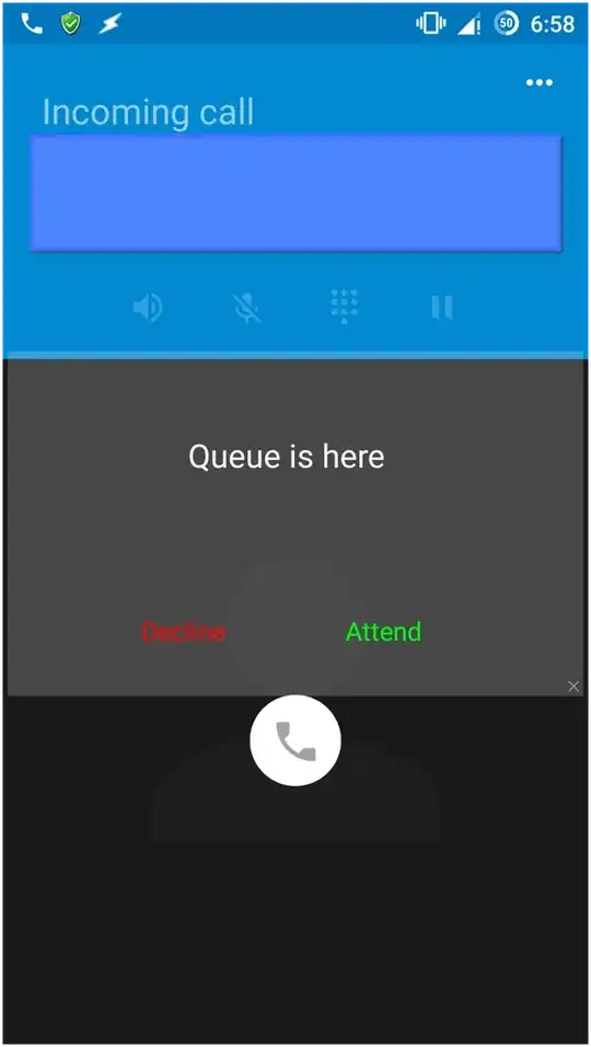

I don't know about any app that would allow creating a contact with wildcard or regex but you can consider Tasker to execute a particular action as a recognition of those particular numbers.
  • Profile: State → Phone → Call
    • Type: Incoming
    • Number: *01
      * is the wildcard here which would match anything. 01 is the suffix you want at the end of the number.
How you want to recognize those numbers is up to you. Under a task you can show a:
  • Toast: Alert → Flash
  • Notification: Alert → Notify
  • Popup: Alert → Popup
  • May be, a Scene like this:
    (Click image to enlarge)
    IMG:
