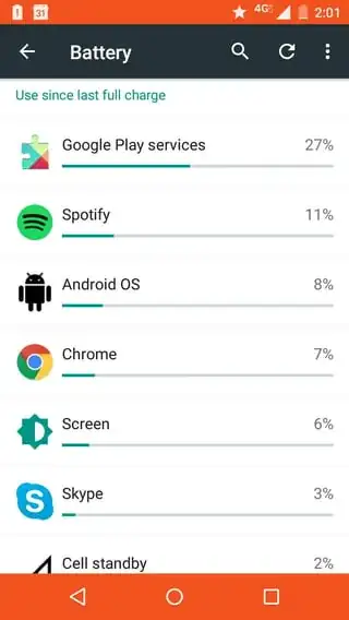

If you want proof, here is what my cellular battery usage is when I forget to use Greenify all day.
(Click image to enlarge)
And when I use it vigorously
