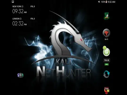

You may need to be rooted. You will need to install terminal emulator. You may also need to install some type of script management tool.
in terminal run:
to display current window manager settings run
wm size && wm density
Output ,for my device, yours will vary,
Physical size: 800x1280
Physical density: 180
To set to required size , [landscape]
wm size 768x1024
stop && start
NOTE: You WILL need to repeat the process to set your screen back to normal so, keep note of your original screen size. This is why i suggest a script management tool.
To return screen to original size; [my device, landscape]
wm size 800x1280
stop && start
You may need to reset your lockscreen wallpaper, mine doesn't seem to restore to proper size when i perform these commands.
