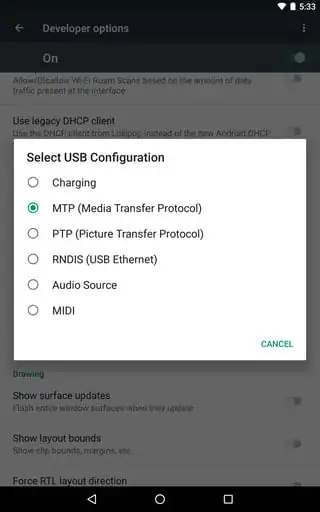

The USB settings in the image above is used to determine what drivers are enumerated when connecting your phone to the PC via USB cable. It is a multiplexer switch which determines whether the USB port is directly connected to the CP or the AP.
There are also options to select device features that will be enabled once connected to the PC. These options include:
  • MTP (Media Transfer Protocol)
  • ADB (Android Debugging Bridge)
  • PTP (Picture Transfer Protocol)
  • RNDIS (Remote Network Driver Interface Specification) for USB Ethernet
  • DM (Diagnostic Mode)
  • MIDI (Used to connect MIDI device such as MIDI keyboard)
  • Modem
USB connection Options
Click on image to enlarge
More info can be found on XDA forums and in 3G, 4G and Beyond by Martin Sauter.
