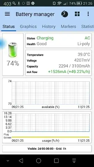

I have a couple of apps to suggest:
  • Galaxy Charging Current is specifically oriented towards Samsung devices and it shows a compatibility list. Your phone is not compatible going by that list but I have seen it work on Note 1 and neo models of Samsung, which are not listed
  • 3C Tool Box. This is a very versatile app and battery related monitoring is a tiny portion of what it can do. Relevant to your question is that it shows charging current while on charge (Also discharge current/ voltage while in use). Snapshot below of charging on my device
