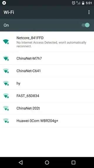

My experience is that Android verifies the connection to a google server.
Guess what's blocked here (China). Right. Google.
Apparently Android's new policy is to prevent auto-connecting to trusted networks if it can't see any internet on the network. Which of course there is, may it be slower and limited to the Chinese Firewall.
So far I haven't found a way in Android to disable this check. And I'm forced to use 3rd party apps to solve this issue.
If I ever find a proper fix, I'll definitely post it here.
Failing to auto-connect
Screenshot - Failed to auto-connect (Click to enlarge image)
