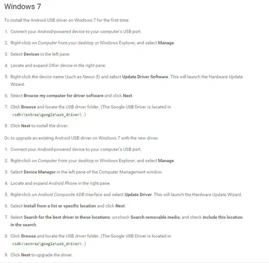

Edit - I forgot to mention that I have also looked in to downloading the Google USB driver - http://developer.android.com/sdk/win-usb.html#download
However, I'm running Windows 7 x64, and it appears that these drivers are only suitable for x86 installations.
I've now also downloaded the Universal Windows ADB Driver Universal Windows ADB Driver as recommended on this site, but still no joy - USB Debugging is not showing in ADB devices
You can install the drives on your windows platform as it is 64-bit (64-bit can and will run 32-bit code (x86 is what you called it in your question)), so install the drivers and try again.
Install Drivers
To check that windows can communicate to the adb interface:
  • Make sure the phones adb setting is turned on, and connect the phone to the computer
  • Navigate to the windows device manager.
  • If everything is correct (the correct drivers are installed, phones adb is turned on and the phone is communicating to the computer) you should see "Android ADB" on top of the device managers list.
  • If it isn't, install the correct drives for your phone and make sure the ADB setting is turned on in your phone
