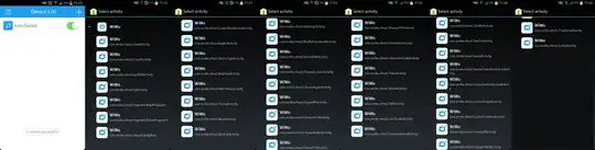

WiWo is an app for controlling a WiFi socket. Unfortunately it has no Tasker integration or even a widget.
I was therefore wondering whether I could hook into any of the app's activities (image below) in order to toggle the switch for the socket on/off out with the app?
Other ideas/options welcome.
Wiwo - Activities
