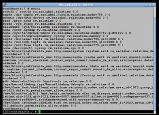

In a first "operative step", you need to evaluate what partitions there are, and which each of them uses. Open your terminal (or run adb shell) to get to the , and invoke the mount command. For what to expect, let me steal a screenshot from this post:
output of mount command
Example output of the mount command (click image for larger variant)
Now, not all entries are relevant to you. Check Android Folder Hierarchy to pick those you're interested in. For your case, the one holding /data/data will be of special interest. The example screenshot has it in the line with /dev/block/platform/dw_mmc.0/by-name/userdata, and we see it is using Android Folder Hierarchy as file system – more specifically: EXT4.
You might also wish to check other partitions, but make sure to stick to those with "real file systems" – and skip things like rootfs, tmpfs, sysfs, cgroup, etc. Basically, all those partitions you're interested in will most likely use either some extfs, or (for the SDCard) some FAT.
