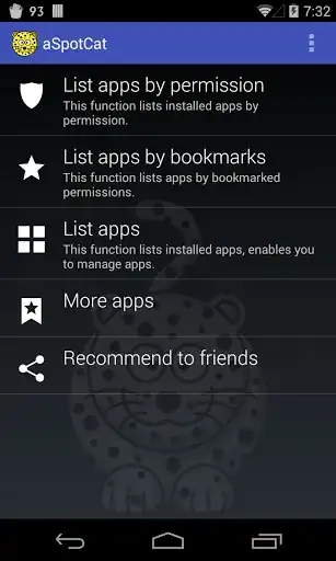

To find all apps with a specific permission, there's a much easier way then checking them each manually: use a Permission Checker. I'd recommend taking a look at aSpotCat, which is around for quite a while (I remember it even back from Eclair in 2011 :)
aSpotCat aSpotCat [aSpotCat]

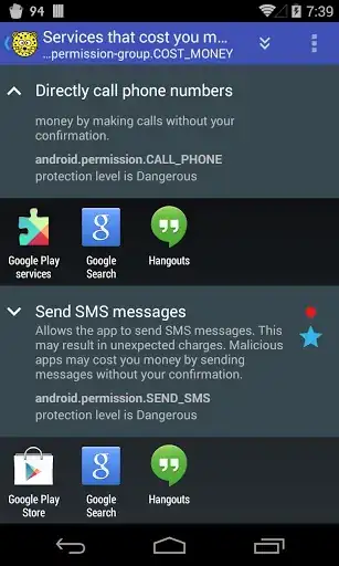

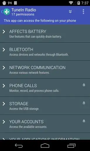

aSpotCat allows you to browse your installed apps by permissions (and more, see first screenshot). Especially for your question is the second screenshot: see what apps can send SMS messages. To make it easier for you to find a permission, they are grouped (third screenshot).
Now, restricting access is a different thing. Multiple approaches can be thought of, but they are often either specific to an Android version (e.g. AppOps are only available with Android 4.3 and 4.4), require root, or need to manipulate and re-install the apps (thus often preventing updates, as modifications also change the app signature). As you're using Kitkat, the first group should fit your needs, and you can check for some AppOps FrontEnds. If your device is rooted, you might also take a look at some Stand-Alone Permission Manager. For further details on those, please also visit our sister-site for Software-Recommendations, and see: Android permissions manager.
