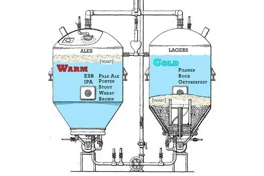

A pictty good summary: enter image description here
(Source: BeerSci: What Is The Difference Between A Lager And An Ale?)
The first part of the picture depicts the description in my answer about where the yeast "works," the temperatures at which they work, and then some common types of ales/lagers. The second picture shows S. cerevisiae (common ale yeast) and a wild yeast S. eubayanus making some new cold tolerant yeast strain babies that are the common lager yeast (S. pastorianus). Note: my biology is rusty but from my reading and looking at the picture, this is what I derived.

  • Could you perchance explain what's going on in the picture? – wax eagle Jan 29 '14 at 04:51
  • @waxeagle The first part of the picture depicts the description in my answer about where the yeast "works," the temperatures at which they work, and then some common types of ales/lagers. The second picture shows S. cerevisiae (common ale yeast) and a wild yeast S. eubayanus making some new cold tolerant yeast strain babies that are the common lager yeast (S. pastorianus). Note: my biology is rusty but from my reading and looking at the picture, this is what I derived. – BryceH Jan 29 '14 at 15:40

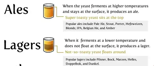

This is pretty good explanation
Source: Twenty Things Worth Knowing About Beer.
