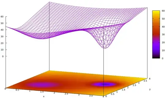

Simulated annealing is a materials science analogy and involves the introduction of noise to avoid search failure due to local minima. See images below. To improve the odds of finding the global minimum rather than a sub-optimal local one, a stochastic element is introduced by simulating Brownian (thermal) motion. Variants of simulated annealing include injection of random numbers with various distributions and the averaging effect of mini-batching (dividing a batch into segments and performing network parameter adjustment after each).

Error Surface Showing How Global Optimum Can be Missed
