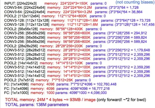

In general in any CNN the maximum time of training goes in the Back-Propagation of errors in the Fully Connected Layer (depends on the image size). Also the maximum memory is also occupied by them. Here is a slide from Stanford about VGG Net parameters:
Clearly you can see the fully connected layers contribute to about 90% of the parameters. So the maximum memory is occupied by them.

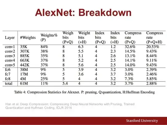

Also here is the parameter chart of AlexNet:

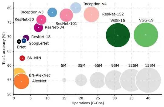

And here is a performance comparison of various CNN architectures:
