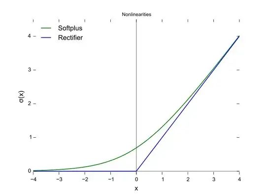

It's only like ReLU in the sense that they require a threshold before anything happens. But ReLU can have variable output while neurons are all-or-nothing.
Also ReLU (and other activation functions in general) are differentiable with respect to input space. This is very important for backprop.
This is a ReLU function, with the X-axis being input value and Y-axis being output value. enter image description here
And this is the action potential with the X-axis being time, and Y being output value.enter image description here
