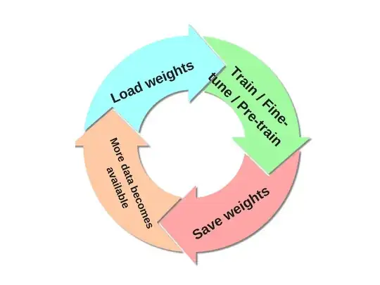

Here is one way you could do that.
After training your network, you can save its weights to disk. This allows you to load this weights when new data becomes available and continue training pretty much from where your last training left off. However, since this new data might come with additional classes, you now do pre-training or fine-tuning on the network with weights previously saved. The only thing you have to do, at this point, is make the last layer(s) accommodate the new classes that have now been introduced with the arrival of your new dataset, most importantly include the extra classes (e.g., if your last layer initially had 10 classes, and now you have found 2 more classes, as part of your pre-training/fine-tuning, you replace it with 12 classes). In short, repeat this circle :
