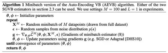

The Auto-Encoding Variational Bayes (AEVB) is the algorithm used to find the parameters $\boldsymbol{\theta}$ and $\boldsymbol{\phi}$, as you can conclude by reading its pseudocode given in the paper.
The AEVB algorithm stochastically estimates the gradient of the objective function, i.e. the Evidence Lower BOund (ELBO) (equation 3). They propose 2 estimators (equations 6 and 7), of the ELBO (not its gradient, which is computed automatically by back-propagation; note that stochastic estimation of the gradient of the objective function is very common in deep learning: see this). Moreover, the AEVB algorithm also uses the re-parametrization trick (i.e. it samples from $p(\boldsymbol{\epsilon})$ to avoid high variance).

So, to recap, the AEVB is the training/learning/inference algorithm to find $\boldsymbol{\phi}$ and $\boldsymbol{\theta}$. The AVB stochastically estimates the ELBO (and, consequently, its gradient) and uses the re-parametrization trick. If you use a neural network to represent the encoder and the decoder, you get the VAE, which is not the same thing as the AEVB, the algorithm to find the parameters of the neural networks (i.e. the encoder and decoder).

  • @a12345 Yes, it's an estimator of the ELBO objective function, not its gradient (which is computed automatically with back-propagation). In the paper/pseudocode, the gradient of the estimator is denoted by $\mathbf{g}$. You can see there they use $$\nabla_{\boldsymbol{\theta}, \boldsymbol{\phi}} \widetilde{\mathcal{L}}^{M}\left(\boldsymbol{\theta}, \boldsymbol{\phi} ; \mathbf{X}^{M}, \boldsymbol{\epsilon}\right)$$. Anyway, you can ask this in a separate question too, and I will provide this answer there. Maybe this question can be useful for future readers. – nbro Oct 29 '21 at 19:53
