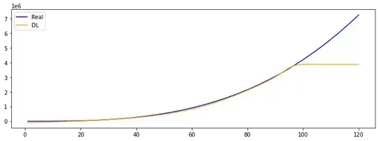

You're trying to learn a cubic function that explodes in values and your issue is scaling. I have been able to learn a better approximation by scaling data and using tanh as activation function.
Code and result are as below:
Convergence around X=100 happens because of tanh activation. Relu will not work better because of negative values that is the result of scaling. You can try playing with Leaky Relu activation and various alpha values.

f, ax = plt.subplots(figsize = (12, 4)) ax.plot(sorted(scaler_X.inverse_transform(X_test).reshape(-1)), sorted(y_test), color = 'blue', label = 'Real') ax.plot(sorted(scaler_X.inverse_transform(X_test).reshape(-1)), sorted(y_hat), color = 'orange', label = 'DL') ax.legend()

  • Excellent. Rather surprising for me because I have read that relu should (almost) always work. For the moment I do not undersand the divergence with values bigger than 100. I will study your answer and try all your suggestions. I hope I shall be able to fit it beyond 100 :). I supposed that it was not neccesary to do any sort of "feature engineering", as is very frequently asserted. – – Hermes Morales Jul 26 '21 at 13:51
    For better understanding, inspect tanh figure, it maps $(-\infty, \infty)$ to $(-1, 1)$. Having clarified that, inspect the scaled value of the mass of $R = 100$.
    scaler_y.transform(np.array([[mass_of_sphere(100)]]))
    You can simply bypass this limitation by either changing activation function or using a higher range of training values, going for perhaps 500 instead of 120.
    I just tested with values between (1, 500) and convergence occured at 400. Not an elegant solution but good to have.
