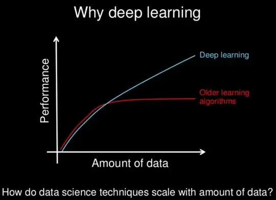

  • All things equal, deep learning models generally rank supreme when compared to other algorithms as the size of the dataset increases:
    why deep learning
