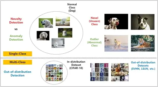

Below is a figure from What is anomaly detection?

  • Thanks for the answer. What do you mean by "Out-of-distribution detection is essentially running your model on OOD data." and "So one takes OOD data and does novelty detection or anomaly detection (aka outlier detection)."? – mhdadk Jan 25 '21 at 14:57
    I updated the answer with a figure which might help although it could be better written. The data on the left is what was used to train the model. The data on the right, for single and multi-class, are OOD. – Brian O'Donnell Jan 25 '21 at 16:49
