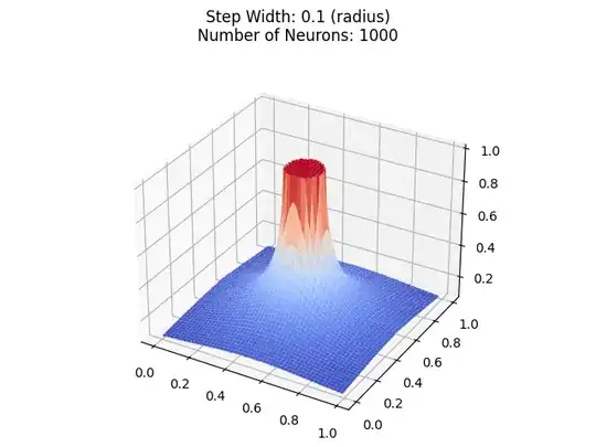

Let's start with a simple tower of radius 0.1:

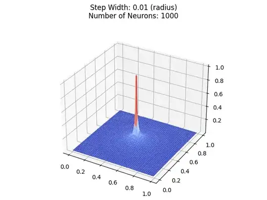

Now let's decrease the radius to 0.01:
Now, you might think that it gets close to a cylinder, but it just looks like it is approximating a perfect cylinder, because of the zoomed out effect.
Let's zoom in:
Let's decrease the radius to 0.0000001.
Still not a perfect cylinder. In fact, the "quality" of the cylinder is the same.

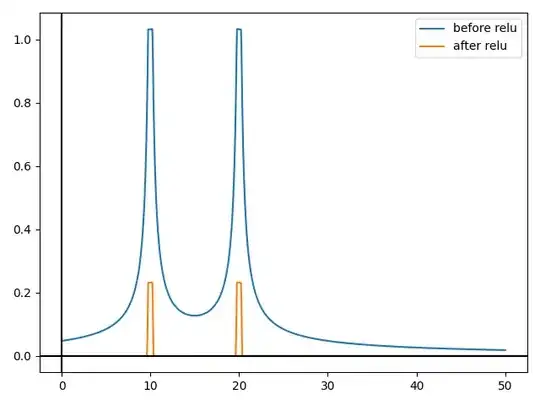

The more I think about it the more convinced I am that the visual explanation from the linked lecture is wrong. But the good news is there are still some ways to get close to the cylinder but not before the activation of the last neuron but instead afterwards. I haven't done it with simgoid. But I tried with ReLu instead for now.
We can cut the tower at the very top (thanks to ReLu and a bias). The closer to the top we cut it the more it will be like a cylinder.
We can control the height of the tower with the weights.
First in 2d:

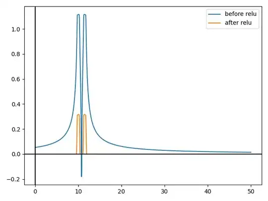

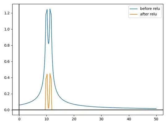

Unfortunately the closer we put this towers together the more they will start two influence each other.
But we can counter that with a negative tower between them. enter image description here

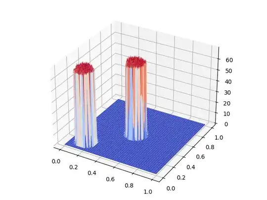

Now in 3d:
This Answer is work in progress I will update it when i find out something new.

I think you misunderstood that part of the proof: you first need a limit on the number of neurons to get closer and closer to a cylinder. You are keeping them constant at 1000, thus indeed not getting any closer to the cylinder and exponential vanishing behavior.
Once you have the "epsilon-perfect" circles/cylinders, then you make them smaller and smaller, thus needing more and more copies of the "1-circle" setup.
My understanding is that this proof has those two numbers going to infinity: neurons-to-approximate-cylinder, and number-of-cylinders. You took into account the latter, but not the former.
