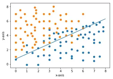

Say in a problem like this, if you apply the perceptron learning algo., do you have any realistic way to predict where the final decision boundary will rest? Whereas, if you train it by continuous methods, you can easily plot the cost function versus weights, check the global minima, get the weights which will be the final weights. So we easily solved it by plotting (definite matrix methods also exist).
