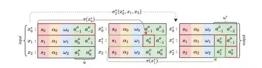

4. Partial Trajectory resampling (PTR)
A method that recursively resamples actions in the buffer, replacing them with on-policy actions. It uses the delay dynamics to simulate their effect on the current policy.
If random delays exist on an MDP, some actions present in the off-policy replay buffer will not influence the later delayed observations and rewards, for a number of timesteps. This will allow generation of on-policy sub-trajectories from the off-policy samples by recursively resampling the most recent actions from the action buffer. It will not invalidate the sub-trajectory.
The resampled action will be valid as long as the observation delay $\omega$ and the action delay $\alpha$ are both greater than the current time step $t$ i.e., No delayed observation depends on a resampled action.
$$ \omega_t + \alpha_t >= t $$
Partial trajectory resampling Illustration of PTR, (3)
The benefits of this method:
  1. Allows discarding of outdated information. e.g If the delay is such that the are no observations for $5$ timesteps, which then all arrive at step $5$, we can safely discard the transitions of steps $(1,2, 3,4)$. This is because this info will be compressed in the most recent observation.
  2. Provides information on the "age" of an observation and the actions applied next
  3. Efficient credit assignment
These factors give partial trajectory resampling better performance compared to concatenating the past $K$ actions with the most recent observation to estimate the current delayed state.
RL with random delays (2020)[3] describes and applies Partial Trajectory Resampling in RL. It's the only work I've managed to come across that handles both random and constant delayed MDPs.
