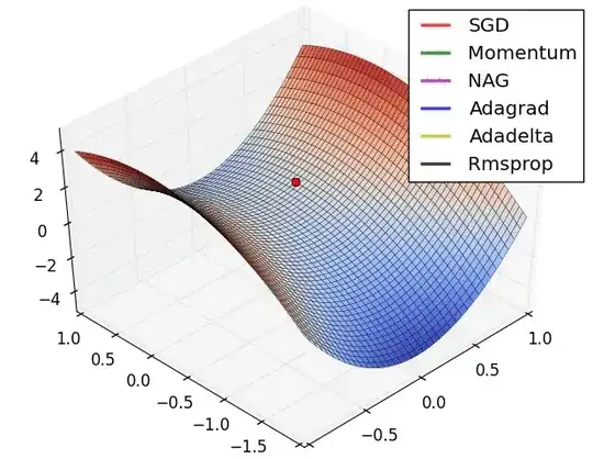

Also, second-order gradients can help the optimizer identify states like saddle points, and help the solver get out of those states. Saddle points give standard gradient descent a lot of issues, as the gradient descent has difficulty and is slow to move out of the saddle point. Fixing the saddle point issue is one of the motivations for improving gradient descent over the last two decades (SDG with momentum, adaptive learning rates, ADAM, etc). More info.
